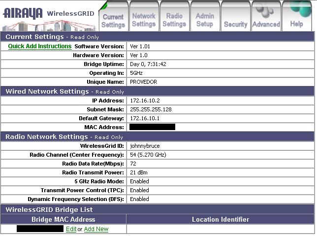

  13. #33
    Tenho um link de 3.5KM com airaya, deem uma olhada nos resultados...
    Airaya em cima do predio:
    PING 172.16.10.2 (172.16.10.2): 56 data bytes
    64 bytes from 172.16.10.2: icmp_seq=0 ttl=64 time=0.393 ms
    64 bytes from 172.16.10.2: icmp_seq=1 ttl=64 time=0.770 ms
    64 bytes from 172.16.10.2: icmp_seq=2 ttl=64 time=0.770 ms
    64 bytes from 172.16.10.2: icmp_seq=3 ttl=64 time=0.771 ms
    64 bytes from 172.16.10.2: icmp_seq=4 ttl=64 time=0.771 ms
    64 bytes from 172.16.10.2: icmp_seq=5 ttl=64 time=0.770 ms
    64 bytes from 172.16.10.2: icmp_seq=6 ttl=64 time=0.773 ms
    64 bytes from 172.16.10.2: icmp_seq=7 ttl=64 time=0.768 ms
    64 bytes from 172.16.10.2: icmp_seq=8 ttl=64 time=0.768 ms
    E esse aqui lá no morro:
    PING 172.16.10.3 (172.16.10.3): 56 data bytes
    64 bytes from 172.16.10.3: icmp_seq=0 ttl=64 time=1.785 ms
    64 bytes from 172.16.10.3: icmp_seq=1 ttl=64 time=1.011 ms
    64 bytes from 172.16.10.3: icmp_seq=2 ttl=64 time=1.018 ms
    64 bytes from 172.16.10.3: icmp_seq=3 ttl=64 time=1.019 ms
    64 bytes from 172.16.10.3: icmp_seq=4 ttl=64 time=1.001 ms
    64 bytes from 172.16.10.3: icmp_seq=5 ttl=64 time=1.021 ms
    64 bytes from 172.16.10.3: icmp_seq=6 ttl=64 time=1.018 ms
    64 bytes from 172.16.10.3: icmp_seq=7 ttl=64 time=1.018 ms
Nome:	         airaya2.JPG
Visualizações:	83
Tamanho: 	68,5 KB
