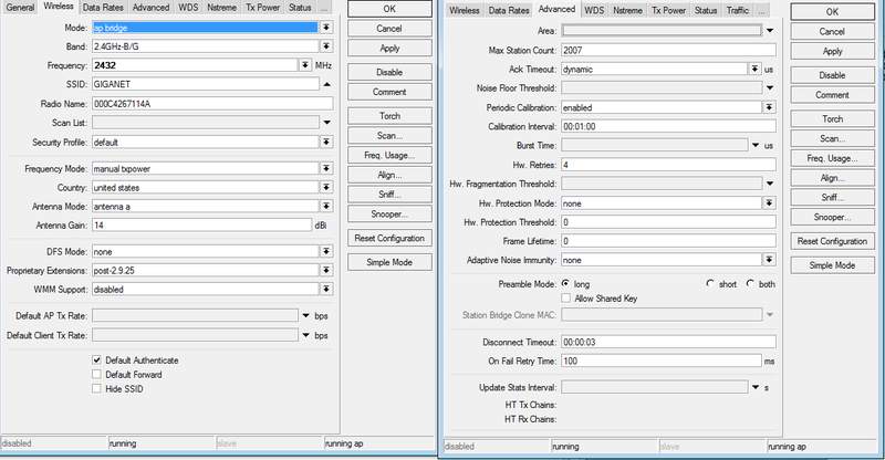

    Ai as configuraçoes. Ja coloquei a Banda em G B mas com B/G ficou melhor =x...
    Lembrando que a distancia maxima dos meus clientes é de 2 Km

    /interface bridge
    add admin-mac=00:00:00:00:00:00 ageing-time=5m arp=enabled auto-mac=yes comment="" disabled=no forward-delay=15s l2mtu=1526 max-message-age=20s mtu=1500 name=bridge1 \
    priority=0x8000 protocol-mode=none transmit-hold-count=6
    /interface ethernet
    set 0 arp=enabled auto-negotiation=yes comment="" disabled=no full-duplex=yes l2mtu=1526 mac-address=00:0C:42:4C:EE:BD mtu=1500 name=ether1 speed=100Mbps
    /interface wireless security-profiles
    set default authentication-types="" eap-methods=passthrough group-ciphers="" group-key-update=5m interim-update=0s management-protection=disabled \
    management-protection-key="" mode=none name=default radius-eap-accounting=no radius-mac-accounting=no radius-mac-authentication=no radius-mac-caching=disabled \
    radius-mac-format=XX:XX:XX:XX:XX:XX radius-mac-mode=as-username static-algo-0=none static-algo-1=none static-algo-2=none static-algo-3=none static-key-0="" \
    static-key-1="" static-key-2="" static-key-3="" static-sta-private-algo=none static-sta-private-key="" static-transmit-key=key-0 supplicant-identity=MikroTik \
    tls-certificate=none tls-mode=no-certificates unicast-ciphers="" wpa-pre-shared-key="" wpa2-pre-shared-key=""
    /interface wireless
    set 0 ack-timeout=dynamic adaptive-noise-immunity=none allow-sharedkey=no antenna-gain=14 antenna-mode=ant-a area="" arp=enabled band=2.4ghz-b/g basic-rates-a/g=6Mbps \
    basic-rates-b=1Mbps burst-time=disabled comment="" compression=no country="united states" default-ap-tx-limit=0 default-authentication=yes default-client-tx-limit=0 \
    default-forwarding=no dfs-mode=none disable-running-check=no disabled=no disconnect-timeout=3s frame-lifetime=0 frequency=2432 frequency-mode=manual-txpower \
    frequency-offset=0 hide-ssid=no hw-fragmentation-threshold=disabled hw-protection-mode=none hw-protection-threshold=0 hw-retries=4 l2mtu=2290 mac-address=\
    00:0C:42:67:11:4A max-station-count=2007 mode=ap-bridge mtu=1500 name=OMINI noise-floor-threshold=default on-fail-retry-time=100ms periodic-calibration=enabled \
    periodic-calibration-interval=60 preamble-mode=long proprietary-extensions=post-2.9.25 radio-name=000C4267114A rate-set=default scan-list=default security-profile=\
    default ssid=GIGANET station-bridge-clone-mac=00:00:00:00:00:00 supported-rates-a/g=6Mbps,9Mbps,12Mbps supported-rates-b=1Mbps,2Mbps,5.5Mbps,11Mbps tx-power-mode=\
    default update-stats-interval=disabled wds-cost-range=50-150 wds-default-bridge=bridge1 wds-default-cost=100 wds-ignore-ssid=yes wds-mode=static wmm-support=\
    disabled
    /interface wireless nstreme
    set OMINI comment="" disable-csma=no enable-nstreme=no enable-polling=yes framer-limit=3200 framer-policy=none
    /interface wireless manual-tx-power-table
    set OMINI comment="" manual-tx-powers="1Mbps:17,2Mbps:17,5.5Mbps:17,11Mbps:17,6Mbps:17,9Mbps:17,12Mbps:17,18Mbps:17,24Mbps:17,36Mbps:17,48Mbps:17,54Mbps:17,HT20-0:17,HT2\
    0-1:17,HT20-2:17,HT20-3:17,HT20-4:17,HT20-5:17,HT20-6:17,HT20-7:17,HT40-0:17,HT40-1:17,HT40-2:17,HT40-3:17,HT40-4:17,HT40-5:17,HT40-6:17,HT40-7:17
    Última edição por darksimoes; 05-03-2011 às 23:09.

    Padrão Re: [ Ajuda ] RB411AH
    Estou me referindo a parte em q tem :
    Frequency Mode : Manual Txpower
    Country: Unites Stats
    Antena mode: Antena A
    Antena Again: 15 Dbi
    em wirelles aqui esta desse modo... devo mudar algo ?
