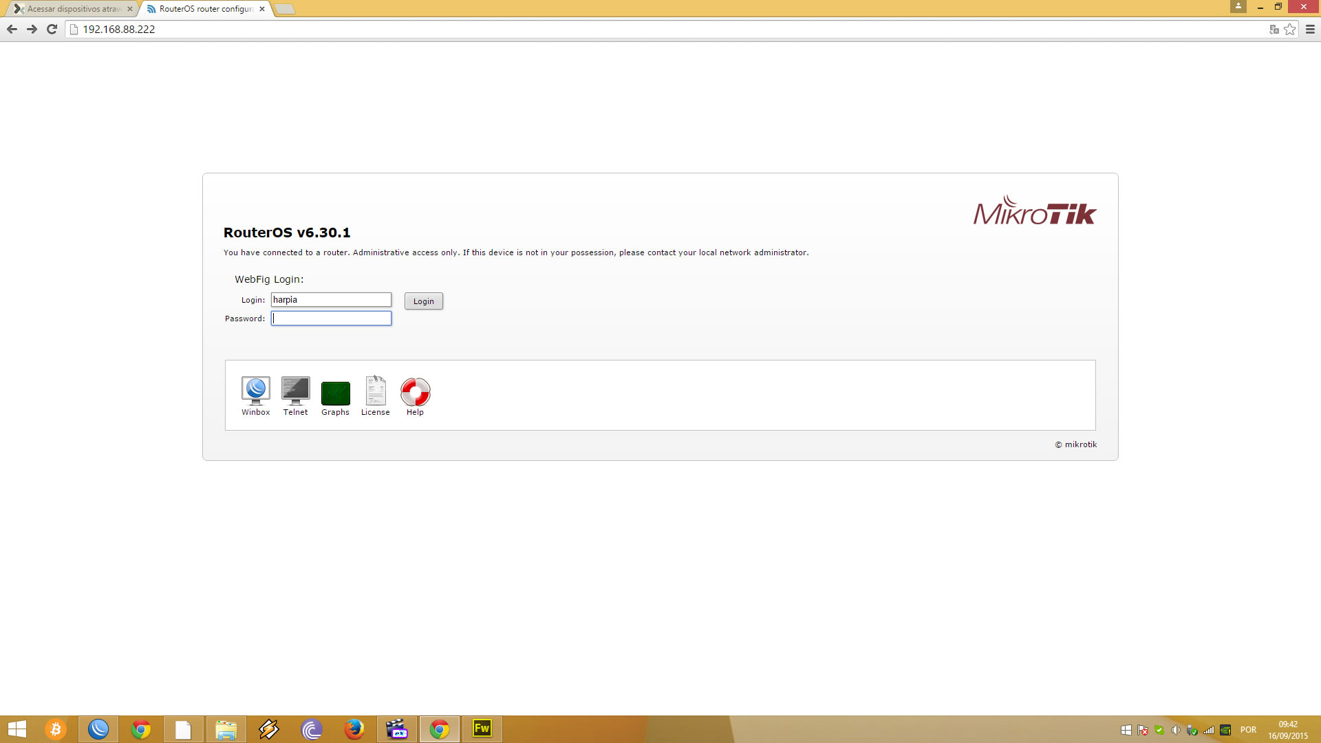

    Padrão Re: Acessar dispositivos através do mikrotik.
    Toda vez que tento acessar o rádio cai nessa página

    E essa é a minha configuração:
    [harpia@MikroTik] > export
    # sep/16/2015 09:41:07 by RouterOS 6.30.1
    # software id = 1A6A-RRN5
    /interface ethernet
    set [ find default-name=ether1 ] name=NET1
    set [ find default-name=ether2 ] name=NET2
    set [ find default-name=ether5 ] name=TORRE
    /ip hotspot profile
    add dns-name=google hotspot-address=192.168.129.2 name=hsprof1
    /ip pool
    add name=pool.PPPOE ranges=192.168.88.2-192.168.88.253
    add name=dhcp_pool1 ranges=2.168.88.221-192.168.88.2
    add name=hs-pool-3 ranges=192.168.129.1,192.168.129.3-192.168.129.254
    add name=vpn ranges=192.168.88.2-192.168.88.221
    /ip dhcp-server
    add address-pool=hs-pool-3 disabled=no interface=ether3 lease-time=1h name=\
    dhcp1
    add address-pool=dhcp_pool1 disabled=no interface=TORRE name=dhcp2
    /ip hotspot
    add address-pool=hs-pool-3 disabled=no interface=ether3 name=hotspot1 profile=\
    hsprof1
    /ppp profile
    add local-address=192.168.88.1 name=PPPOE-CLIENTE-IP remote-address=pool.PPPOE
    add name=5mega rate-limit=50000k/5000k
    add name=1mega rate-limit=10000k/1000k
    add local-address=192.168.88.5 name=perfilvpn only-one=yes remote-address=vpn
    /interface pppoe-server server
    add default-profile=PPPOE-CLIENTE-IP disabled=no interface=TORRE max-mru=1480 \
    max-mtu=1480 mrru=1600 service-name=SERVIDOR.PPPOE
    add default-profile=PPPOE-CLIENTE-IP disabled=no interface=ether4 max-mru=1480 \
    max-mtu=1480 mrru=1600 service-name=service1
    /interface pptp-server server
    set authentication=pap,chap,mschap1,mschap2 default-profile=perfilvpn enabled=\
    yes
    /ip address
    add address=192.168.0.2/30 interface=NET1 network=192.168.0.0
    add address=192.168.1.2/30 interface=NET2 network=192.168.1.0
    add address=192.168.88.1/24 interface=TORRE network=192.168.88.0
    add address=192.168.88.2/24 interface=ether4 network=192.168.88.0
    add address=192.168.129.1/24 comment="hotspot network" interface=ether3 \
    network=192.168.129.0
    add address=192.168.88.222 interface=TORRE network=192.168.88.222
    /ip arp
    add address=192.168.88.254 interface=TORRE
    /ip cloud
    set ddns-enabled=yes
    /ip dhcp-server network
    add address=10.5.50.0/24 comment="hotspot network" gateway=10.5.50.1
    add address=192.168.88.0/24 gateway=192.168.88.1
    add address=192.168.129.0/24 comment="hotspot network" gateway=192.168.129.2
    /ip dns
    set servers=8.8.8.8,8.8.4.4
    /ip firewall filter
    add action=passthrough chain=unused-hs-chain comment=\
    "place hotspot rules here" disabled=yes
    /ip firewall mangle
    add chain=prerouting comment="================" dst-address=192.168.88.0/30 \
    src-address=192.168.88.0/30
    add chain=prerouting dst-address=192.168.0.0/30 src-address=192.168.88.0/30
    add chain=prerouting dst-address=192.168.1.0/30 src-address=192.168.88.0/30
    add action=mark-connection chain=prerouting comment="================" \
    connection-mark=no-mark in-interface=NET1 new-connection-mark=\
    NET1_CONEXOES
    add action=mark-connection chain=prerouting connection-mark=no-mark \
    in-interface=NET2 new-connection-mark=NET2_CONEXOES
    add action=jump chain=prerouting comment="==============" connection-mark=\
    no-mark in-interface=TORRE jump-target=POLITICA_DE_ROTEAMENTO
    add action=jump chain=prerouting connection-mark=no-mark in-interface=ether4 \
    add action=mark-routing chain=prerouting comment="==================" \
    connection-mark=NET1_CONEXOES new-routing-mark=NET1_TRAFICO src-address=\
    192.168.88.0/30
    add action=mark-routing chain=prerouting connection-mark=NET2_CONEXOES \
    new-routing-mark=NET2_TRAFICO src-address=192.168.88.0/30
    add action=mark-routing chain=output comment="=================" \
    add action=mark-routing chain=output connection-mark=NET2_CONEXOES \
    add action=mark-connection chain=POLITICA_DE_ROTEAMENTO comment=\
    "====================" dst-address-type=!local new-connection-mark=\
    NET1_CONEXOES per-connection-classifier=both-addresses:2/0
    add action=mark-connection chain=POLITICA_DE_ROTEAMENTO dst-address-type=\
    !local new-connection-mark=NET2_CONEXOES per-connection-classifier=\
    both-addresses:2/1
    /ip firewall nat
    add action=masquerade chain=srcnat out-interface=NET1
    add action=masquerade chain=srcnat out-interface=NET2
    add action=masquerade chain=srcnat comment="pppoe net" src-address=\
    192.168.88.0/30
    add action=masquerade chain=srcnat comment="masquerade hotspot network" \
    src-address=192.168.129.0/24
    add action=masquerade chain=srcnat comment="nat vpn" src-address=\
    192.168.88.0/24
    add action=dst-nat chain=dstnat comment="acesso radio" dst-address=\
    192.168.88.1 dst-port=4040 protocol=tcp to-addresses=192.168.88.222 \
    to-ports=80
    192.168.88.1 dst-port=4040 protocol=udp to-addresses=192.168.88.222 \
    to-ports=80
    192.168.88.222 dst-port=80 protocol=tcp to-addresses=192.168.88.222 \
    to-ports=80
    /ip hotspot user
    add name=harpia password=1234
    /ip route
    add distance=1 gateway=192.168.0.1 routing-mark=NET1_TRAFICO
    add distance=1 gateway=192.168.1.1 routing-mark=NET2_TRAFICO
    add distance=2 gateway=192.168.0.1
    add distance=3 gateway=192.168.1.1
    add distance=1 dst-address=192.168.88.0/24 gateway=TORRE
    add distance=1 dst-address=192.168.88.0/24 gateway=ether3 pref-src=\
    192.168.88.1 scope=10
    Da um export nas configurações do seu mk e cola aqui. Fica mais fácil. Ou se preferir posso tentar te ajudar com um acesso remoto. E colocamos aqui o resultado. Por este pode ser o problema de outros também.
    Já te adicionei no skype. [email protected]
    Graças a ajuda do amigo rimaraujo conseguimos acessar o rádio como pretendido.
    Meu erro foi acrescentar o ip do rádio no adress list, o que fazia com que o mesmo desse acesso a tela de configuração do mikrotik.
    Obrigado a todos.
    Encerrado.
