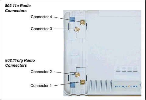

    External Antennas on an AP-4000
    The AP-4000 also has four antenna connectors, two on each radio, for use with external antennas. External antennas can be used with either radio on the AP-4000.
    AP-4000 Image
    Connectors 1 and 2 are for the 802.11b/g radio; connectors 3 and 4 are for the 802.11a radio. When the AP is mounted on a wall, connectors 1 and 4 correspond to the horizontally polarized internal antenna, providing a coverage pattern parallel to the wall; connectors 2 and 3 correspond to the vertically polarized internal antenna, providing a coverage pattern parallel to the ceiling/floor. When the AP is mounted to a ceiling, connectors 1 and 4 correspond to the vertically polarized internal antenna, and connectors 2 and 3 correspond to the horizontally polarized internal antenna. Plugging an external antenna in to the antenna connector disables the corresponding internal antenna on the wireless interface.
    The AP continues to support antenna diversity with external antennas connected. With one external antenna connected to one of the two antenna connectors on a radio, one internal antenna and one external antenna are used for antenna diversity. With two external antennas connected, both external antennas are used for antenna diversity, and both internal antennas are disabled.
    With external antennas connected, you may wish to manually select a particular antenna for use. To do so, disable antenna diversity by manually selecting which antenna to use for each wireless interface through the Command Line Interface.

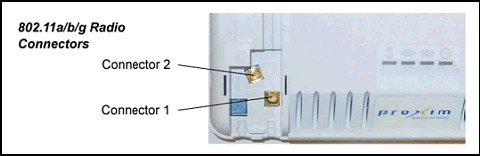

    External Antennas on an AP-700
    The AP-700 also has two antenna connectors for use with external antennas.
    AP-700 Image
    When the AP is mounted on a wall, connector 1 corresponds to the horizontally polarized internal antenna, providing a coverage pattern parallel to the wall; connector 2 corresponds to the vertically polarized internal antenna, providing a coverage pattern parallel to the ceiling/floor. When the AP is mounted to a ceiling, connector 1 corresponds to the vertically polarized internal antenna, and connector 2 corresponds to the horizontally polarized internal antenna. Plugging an external antenna in to the antenna connector disables the corresponding internal antenna.
    The AP continues to support antenna diversity with external antennas connected. With one external antenna connected to one of the two antenna connectors, one internal antenna and one external antenna are used for antenna diversity. With two external antennas connected, both external antennas are used for antenna diversity, and both internal antennas are disabled.
    With external antennas connected, you may wish to manually select a particular antenna for use. To do so, disable antenna diversity by manually selecting which antenna to use through the Command Line Interface.
    Note: Using two external antennas is not recommended, since spatial and polarization diversity is based on distance, positioning, and location of the internal antennas. The addition of external antennas that have not been designed for this diversity will not only disrupt diversity but may lead to the possibility of antenna interference.

    The following commands via the CLI are for enabling or disabling antenna diversity on an AP-4000:
    [device-name] set wif 3 atdiversity <3, 4, 5(auto)>
    [device-name] set wif 4 atdiversity <1, 2, 5(auto)>
    [device-name] reboot
    Explanation wif
    3 = 802.11a
    4 = 802.11b/g
    Explanation atdiversity (connector numbers as shown in the above AP-4000 Image)
    Connector 1 = 802.11b/g
    Connector 2 = 802.11b/g
    Connector 3 = 802.11a
    Connector 4 = 802.11a
    5 = auto; will enable both antenna ports for the corresponding interface
    The following commands via the CLI are for enabling or disabling antenna diversity on an AP-700:
    [device-name] set wif 3 atdiversity <3, 4, 5(auto)>*
    [device-name] reboot <between 0 and 65535>
    Explanation atdiversity (connector numbers as shown in the above AP-700 Image)
    Connector 3 = 802.11a/b/g
    Connector 4 = 802.11a/b/g
    *Please note that as of May 19, 2005, the manual and the above image for the AP-700 has "<1,2, 5(auto)> for atdiverity", but the correct settings are as stated in this Configure section.
