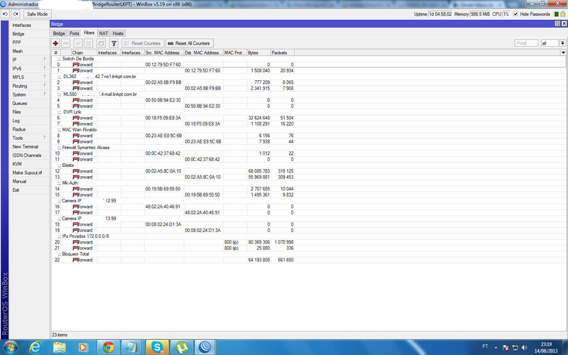

    OLA MEUS AMIGO
    FAÇO ISSO DIFERENTE
    O MEU FUNCIONA ASSIM ...
    MEU LINK CHEGA EM UM CISCO 2600
    NO MIKROTIK CRIO UMA BRIDGE EM E COLOCO DUA INTERFACES NELA
    E APLICO AS REGRAS EM BRIDGE/FILTER
    OBS. COLOCO IP PUBLICO NO CLIENTE E APLICO QoS, FIREWALL, QQ COISA USO ASSIM POR MAIS DE 5 ANOS
    FICA PERFEITO.
    QQ COISA ESTOU ESTAREI A DISPOSIÇÃO ...VLW.
