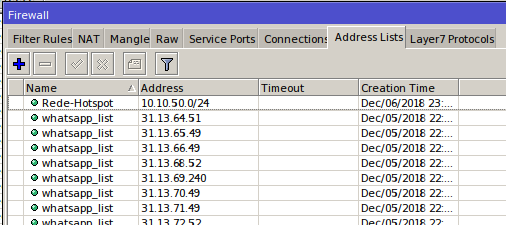

    Segue abaixo o print das regras que fiz:
    1º - Em IP -> Firewall, fazer uma Address List com a rede que você quer liberar somente o Zap e outra com os IPs do Whatsapp.

    Peguei a lista CIRD Whatsapp aqui:
    https://pastebin.com/VVfiN3wi

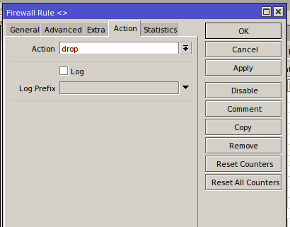

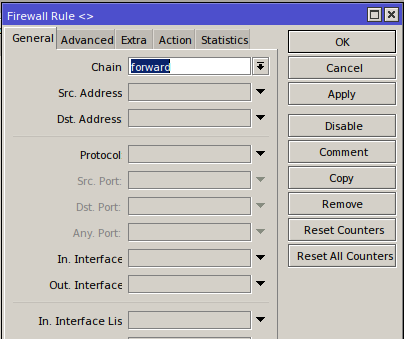

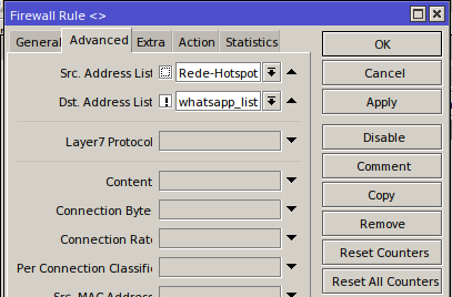

    2º - Ainda no Firewall, em Filter Rules, criar uma regra de DROP, mas liberando tudo que vem da rede Hotspot, para a lista de IPs do Whatsapp.
Nome:	         regra-02.png
Visualizações:	377
Tamanho: 	17,0 KB
    Observe que a exceção em Dst. Address List, está habilitada.
Nome:	         regra-03.png
Visualizações:	336
Tamanho: 	16,2 KB
Nome:	         regra-04.png
Visualizações:	454
Tamanho: 	13,0 KB

    add address=174.37.217.64/27 list=whatsapp_list
    add address=174.37.243.64/27 list=whatsapp_list
    add address=174.37.251.0/27 list=whatsapp_list
    add address=179.60.192.51 list=whatsapp_list
    add address=179.60.195.51 list=whatsapp_list
    add address=184.173.136.64/27 list=whatsapp_list
    add address=184.173.147.32/27 list=whatsapp_list
    add address=184.173.161.64 list=whatsapp_list
    add address=184.173.173.116 list=whatsapp_list
    add address=184.173.179.32/27 list=whatsapp_list
    add address=185.60.216.53 list=whatsapp_list
    add address=185.60.218.53 list=whatsapp_list
    add address=185.60.219.53 list=whatsapp_list
    add address=192.155.212.192/27 list=whatsapp_list
    add address=198.11.193.182/31 list=whatsapp_list
    add address=198.11.251.32/27 list=whatsapp_list
    add address=198.23.80.0/27 list=whatsapp_list
    add address=208.43.115.192/27 list=whatsapp_list
    add address=208.43.117.79 list=whatsapp_list
    add address=10.10.50.0/24 list=Rede-Hotspot
    add address=g.whatsapp.net list=whatsapp_list
    add address=v.whatsapp.net list=whatsapp_list
    add address=mmg.whatsapp.net list=whatsapp_list
    add address=graph.facebook.com list=whatsapp_list
    add address=v-sl.whatsapp.com list=whatsapp_list
    add address=media.ffor2-1.fna.whatsapp.net list=whatsapp_list
    add address=z-m-api.facebook.com list=whatsapp_list
    add address=z-m.c10r.facebook.com list=whatsapp_list
    add address=z-m.facebook.com list=whatsapp_list
    add address=z-1.facebook.com list=whatsapp_list
    add address=chat.cdn.whatsapp.net list=whatsapp_list
    add address=lithium.facebook.com list=whatsapp_list
    add address=b-api.facebook.com list=whatsapp_list
    add address=star.c10r.facebook.com list=whatsapp_list
    add address=star-mini.c10r.facebook.com list=whatsapp_list
    add address=mmx-ds.cdn.whatsapp.net list=whatsapp_list
    add address=mqtt.c10r.facebook.com list=whatsapp_list

    Essa exata regra abaixo vai resolver seu problema, você vai ter que somente adicionar na address-list allow-whatsapp os IP dos usuários ou se preferir adicione o bloco todo de IP.

    /ip firewall filter
    add action=drop chain=forward dst-address-list=!ip_whatsapp dst-port=443,80,21,22,23,25,110,156,143,161,1723 protocol=tcp src-address-list=allow-whatsapp
    add action=drop chain=forward dst-address-list=!ip_whatsapp dst-port=443,80,21,22,23,25,110,156,143,161,1723 protocol=udp src-address-list=allow-whatsapp

    /ip firewall address-list
    add address=31.13.64.51/32 list=ip_whatsapp comment="CIDR WhatsApp"
    add address=31.13.65.49/32 list=ip_whatsapp comment="CIDR WhatsApp"
