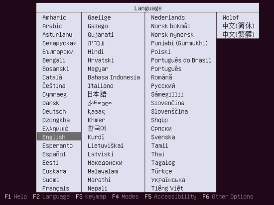

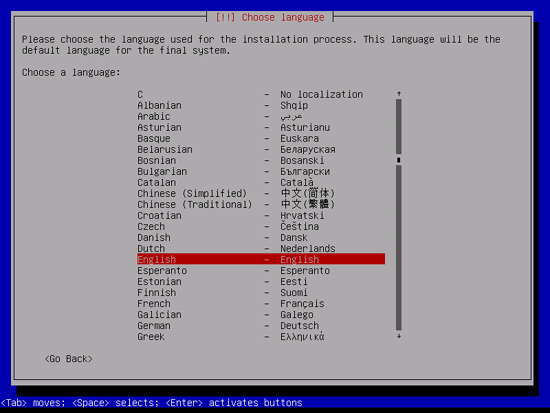

    Insert your Ubuntu install CD into your system and boot from it. Select your language:
Nome:	         1.png
Visualizações:	270
Tamanho: 	42,6 KB

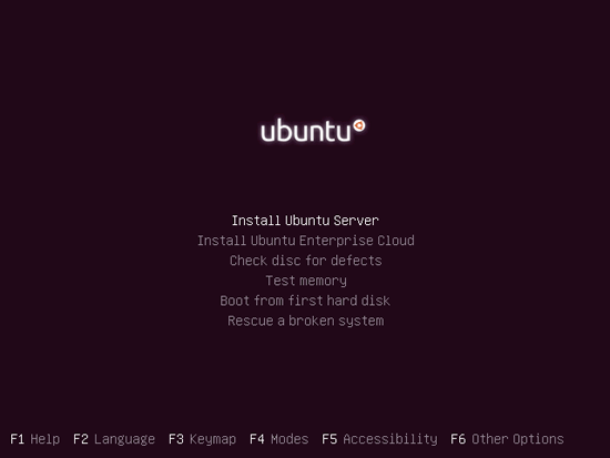

    Then select Install Ubuntu Server:
Nome:	         2.png
Visualizações:	340
Tamanho: 	17,1 KB

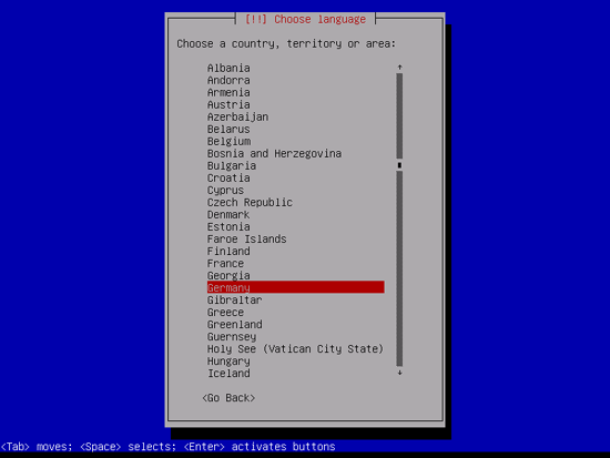

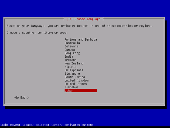

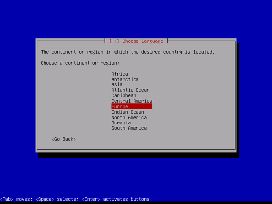

    Then select your location:
Nome:	         4.png
Visualizações:	327
Tamanho: 	15,6 KB

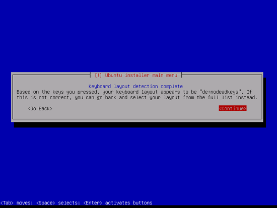

    Choose a keyboard layout (you will be asked to press a few keys, and the installer will try to detect your keyboard layout based on the keys you pressed):
Nome:	         7.png
Visualizações:	279
Tamanho: 	12,3 KB
Nome:	         8.png
Visualizações:	260
Tamanho: 	12,4 KB

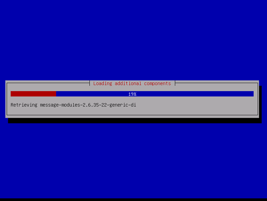

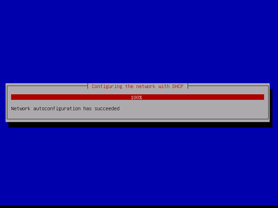

    The installer checks the installation CD, your hardware, and configures the network with DHCP if there is a DHCP server in the network:
Nome:	         9.png
Visualizações:	260
Tamanho: 	7,4 KB
ID:      	15996Clique na imagem para uma versão maior

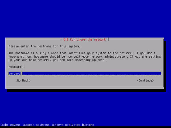

    Enter the hostname. In this example, my system is called server1.example.com, so I enter server1:
Nome:	         11.png
Visualizações:	285
Tamanho: 	14,7 KB

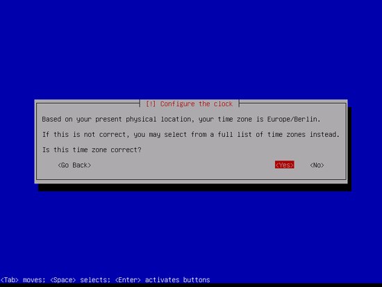

    Please check if the installer detected your time zone correctly. If so, select Yes, otherwise No:
Nome:	         12.png
Visualizações:	264
Tamanho: 	12,0 KB

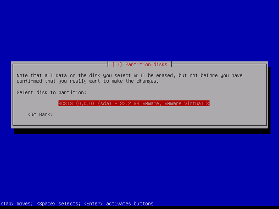

    Select the disk that you want to partition:
Nome:	         14.png
Visualizações:	307
Tamanho: 	12,2 KB

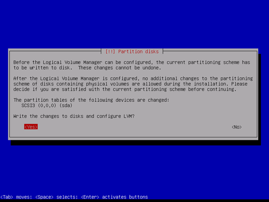

    When you're asked Write the changes to disks and configure LVM?, select Yes:
Nome:	         15.png
Visualizações:	272
Tamanho: 	19,5 KB

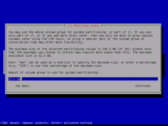

    If you have selected Guided - use entire disk and set up LVM, the partitioner will create one big volume group that uses all the disk space. You can now specify how much of that disk space should be used by the logical volumes for / and swap. It makes sense to leave some space unused so that you can later on expand your existing logical volumes or create new ones - this gives you more flexibility.
Nome:	         16.png
Visualizações:	239
Tamanho: 	24,3 KB

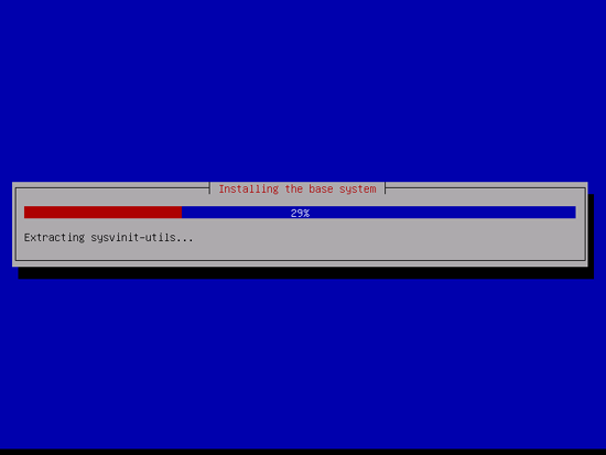

    Now the base system is being installed:
Nome:	         19.png
Visualizações:	240
Tamanho: 	6,8 KB

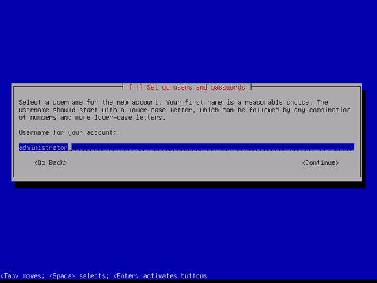

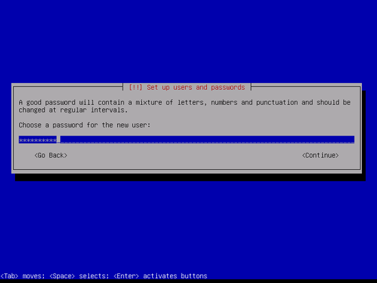

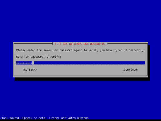

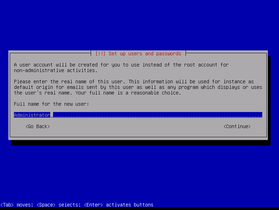

    Create a user, for example the user Administrator with the user name administrator (don't use the user name admin as it is a reserved name on Ubuntu 10.10):
Nome:	         20.png
Visualizações:	348
Tamanho: 	16,6 KB
Nome:	         22.png
Visualizações:	372
Tamanho: 	11,9 KB
ID:      	16008Clique na imagem para uma versão maior
Nome:	         23.png
Visualizações:	272
Tamanho: 	10,8 KB
ID:      	16009Clique na imagem para uma versão maior
Nome:	         21.png
Visualizações:	272
Tamanho: 	13,7 KB

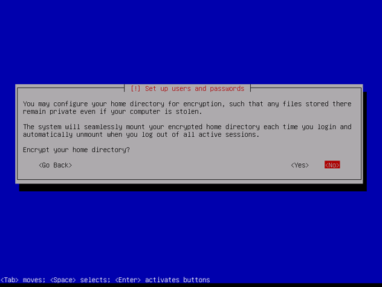

    I don't need an encrypted private directory, so I choose No here:
Nome:	         24.png
Visualizações:	246
Tamanho: 	15,1 KB

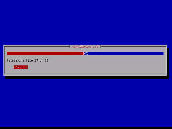

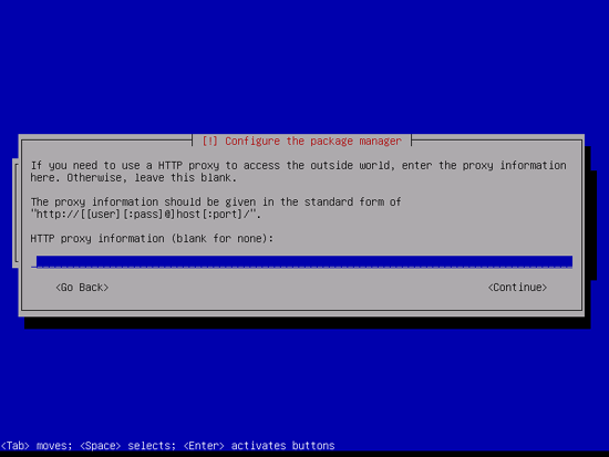

    Next the package manager apt gets configured. Leave the HTTP proxy line empty unless you're using a proxy server to connect to the Internet:
Nome:	         26.png
Visualizações:	241
Tamanho: 	15,1 KB

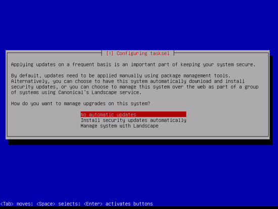

    I'm a little bit old-fashioned and like to update my servers manually to have more control, therefore I select No automatic updates. Of course, it's up to you what you select here:
Nome:	         29.png
Visualizações:	283
Tamanho: 	19,7 KB

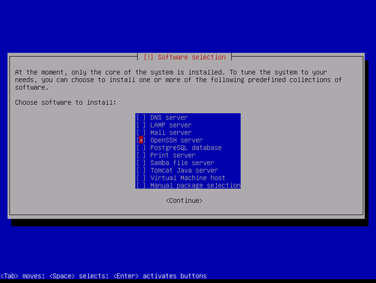

    We need a DNS, mail, and LAMP server, but nevertheless I don't select any of them now because I like to have full control over what gets installed on my system. We will install the needed packages manually later on. The only item I select here is OpenSSH server so that I can immediately connect to the system with an SSH client such as PuTTY after the installation has finished:
Nome:	         30.png
Visualizações:	261
Tamanho: 	15,9 KB

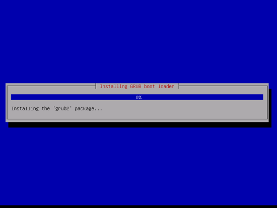

    The GRUB boot loader gets installed:
Nome:	         32.png
Visualizações:	262
Tamanho: 	6,9 KB

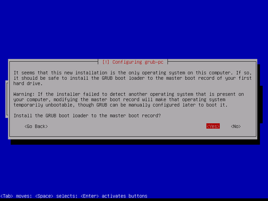

    Select Yes when you are asked Install the GRUB boot loader to the master boot record?:
Nome:	         33.png
Visualizações:	334
Tamanho: 	18,7 KB

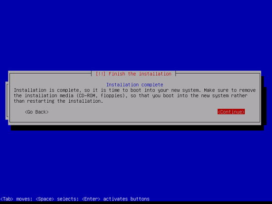

    The base system installation is now finished. Remove the installation CD from the CD drive and hit Continue to reboot the system:
Nome:	         34.png
Visualizações:	291
Tamanho: 	13,0 KB

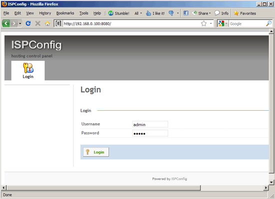

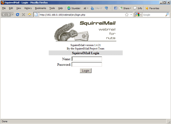

    Command >> <-- QAfterwards you can access SquirrelMail under http://server1.example.com/webmail or http://192.168.0.100/webmail:

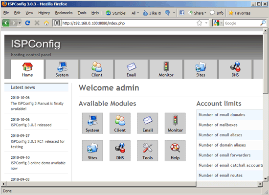

    The installer automatically configures all underlying services, so no manual configuration is needed.
    Afterwards you can access ISPConfig 3 under http://server1.example.com:8080/ or http://192.168.0.100:8080/. Log in with the username admin and the password admin (you should change the default password after your first login):
Nome:	         36.png
Visualizações:	384
Tamanho: 	17,9 KB
ID:      	16021Clique na imagem para uma versão maior
Nome:	         37.png
Visualizações:	364
Tamanho: 	36,8 KB
    The system is now ready to be used.
