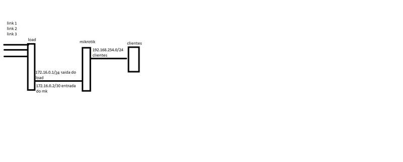

    ola michaelbr boa noite fiz o que vc indicou mas não consergui vc pode por gentileza me dizer a onde esta o meu erro minha rede e basica mente essa

    regras do load para porta 1001
    nat
    add action=dst-nat chain=dstnat disabled=no dst-port=1001 in-interface=!saida \
    protocol=tcp to-addresses=172.16.0.2 to-ports=1001
    mangles
    add action=mark-connection chain=input comment="abertura de porta" disabled=\
    no in-interface="wlan3 network" new-connection-mark=rota3_conn \
    passthrough=yes protocol=tcp
    add action=mark-connection chain=input disabled=no in-interface=\
    "wlan2 network" new-connection-mark=rota2_conn passthrough=yes protocol=\
    tcp
    "wlan1 network" new-connection-mark=rota1_conn passthrough=yes protocol=\
    tcp
    add action=mark-routing chain=output comment="abertura de porta saida" \
    connection-mark=rota1_conn disabled=no new-routing-mark="rota 1" \
    passthrough=yes
    add action=mark-routing chain=output connection-mark=rota2_conn disabled=no \
    new-routing-mark="rota 2" passthrough=yes
    add action=mark-routing chain=output connection-mark=rota3_conn disabled=no \
    new-routing-mark="rota 3" passthrough=yes
    ip route
    add comment="rotas para abertura de porta" disabled=no distance=1 \
    dst-address=0.0.0.0/0 gateway="wlan1 network" scope=30 target-scope=10
    add disabled=no distance=1 dst-address=0.0.0.0/0 gateway="wlan2 network" \
    add disabled=no distance=1 dst-address=0.0.0.0/0 gateway="wlan3 network" \
    essa e do mikrotik com hotspot
    add action=dst-nat chain=dstnat comment="" disabled=no dst-port=1001 \
    in-interface=!cliente protocol=tcp to-addresses=192.168.254.236 to-ports=\
    1001
    esse ip é o da minha maquina se vc pude dizer a onde estou errando ficarei muito agradecido
    boa noite
