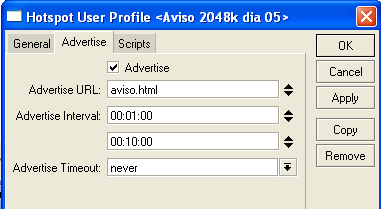

    Ola marquesjr, endossando o que o amigo acima respondeu...
    Na profile de aviso.html vá na aba Advertise ative Advertise Timeout: never

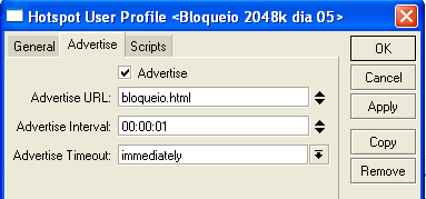

    Na profile de bloqueio.html vá na aba Advertise ative Advertise Timeout: immediately

    Boa sorte a todos e Feliz Natal
