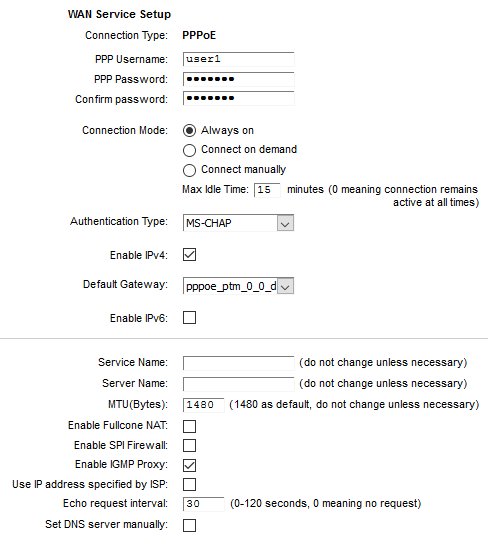

  12. #192
    Hi NahuelVara, and hi Argentina !
    Thank you so much for your answer.
    So I didn't change anything in the MA5616 config neither in the Mikrotik.
    And now this is the VDSL config on the modem (no vlan) :
Nome:	         tpl.jpg
Visualizações:	236
Tamanho: 	43,2 KB
    And this is the diagnostic (same result but in english) :
    Test Internet Browsing
    Test xDSL Synchronization Pass
    ATM OAM Segment Ping Pass
    ATM OAM end to end Ping Pass
    Test PPP Server connection Fail
    It seems I missed 2 tips but not one !
    Do you have any other idea ?
Nome:	         tpl.jpg
Visualizações:	155
Tamanho: 	43,0 KB
