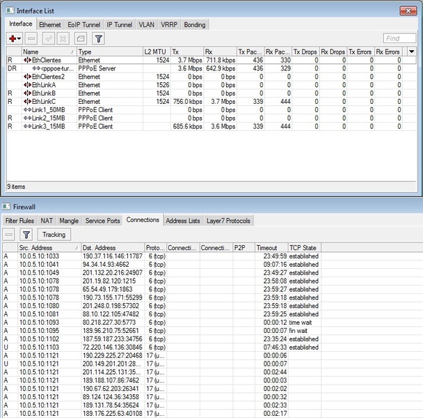

  17. #317
    Boa tarde Amigo
    Estou com um problema e gostaria, se possível de uma ajuda.
    Fiz o Balanceamento PCC como no início do Blog, porem está funcionando da seguinte maneira:
    É utilizado apenas um Link, mesmo com todos conectados mas se eu desligar este link o outro assume autamaticamente, mas é sempre utilizado apenas 1 dos links.
    no meu caso utilizo 3 modens em Bridge com um link de 50MB e 2 de 15MB, da GVT.
    gostaria de uma ajuda para que a utilização dos links seja balanceadas entre os três links
    a seguir as regras...
    /ip firewall mangle
    add action=accept chain=prerouting comment="SEM BALANCE" disabled=no dst-address-list=sem_balance in-interface=EthClientes
    add action=mark-connection chain=input comment="" connection-state=new disabled=no in-interface=EthLinkA new-connection-mark=conn_na passthrough=yes
    add action=mark-connection chain=input comment="" connection-state=new disabled=no in-interface=EthLinkB new-connection-mark=conn_nb passthrough=yes
    add action=mark-connection chain=input comment="" connection-state=new disabled=no in-interface=EthLinkC new-connection-mark=conn_nc passthrough=yes
    add action=mark-routing chain=output comment="" connection-mark=conn_na disabled=no new-routing-mark=to_ra passthrough=no
    add action=mark-routing chain=output comment="" connection-mark=conn_nb disabled=no new-routing-mark=to_rb passthrough=no
    add action=mark-routing chain=output comment="" connection-mark=conn_nc disabled=no new-routing-mark=to_rc passthrough=no
    add action=mark-connection chain=prerouting comment="" disabled=no dst-address-type=!local in-interface=EthClientes new-connection-mark=conn_ma0 passthrough=yes per-connection-classifier=both-addresses:7/0
    add action=mark-connection chain=prerouting comment="" disabled=no dst-address-type=!local in-interface=EthClientes new-connection-mark=conn_mb1 passthrough=yes per-connection-classifier=both-addresses:7/1
    add action=mark-connection chain=prerouting comment="" disabled=no dst-address-type=!local in-interface=EthClientes new-connection-mark=conn_mc2 passthrough=yes per-connection-classifier=both-addresses:7/2
    add action=mark-connection chain=prerouting comment="" disabled=no dst-address-type=!local in-interface=EthClientes new-connection-mark=conn_md3 passthrough=yes per-connection-classifier=both-addresses:7/3
    add action=mark-connection chain=prerouting comment="" disabled=no dst-address-type=!local in-interface=EthClientes new-connection-mark=conn_me4 passthrough=yes per-connection-classifier=both-addresses:7/4
    add action=mark-connection chain=prerouting comment="" disabled=no dst-address-type=!local in-interface=EthClientes new-connection-mark=conn_mf5 passthrough=yes per-connection-classifier=both-addresses:7/5
    add action=mark-connection chain=prerouting comment="" disabled=no dst-address-type=!local in-interface=EthClientes new-connection-mark=conn_mg6 passthrough=yes per-connection-classifier=both-addresses:7/6
    add action=mark-routing chain=prerouting comment="" connection-mark=conn_ma0 disabled=no in-interface=EthClientes new-routing-mark=to_nra passthrough=no
    add action=mark-routing chain=prerouting comment="" connection-mark=conn_mb1 disabled=no in-interface=EthClientes new-routing-mark=to_nrb passthrough=no
    add action=mark-routing chain=prerouting comment="" connection-mark=conn_mc2 disabled=no in-interface=EthClientes new-routing-mark=to_nrc passthrough=no
    add action=mark-routing chain=prerouting comment="" connection-mark=conn_md3 disabled=no in-interface=EthClientes new-routing-mark=to_nrd passthrough=no
    add action=mark-routing chain=prerouting comment="" connection-mark=conn_me4 disabled=no in-interface=EthClientes new-routing-mark=to_nre passthrough=no
    add action=mark-routing chain=prerouting comment="" connection-mark=conn_mf5 disabled=no in-interface=EthClientes new-routing-mark=to_nrf passthrough=no
    add action=mark-routing chain=prerouting comment="" connection-mark=conn_mg6 disabled=no in-interface=EthClientes new-routing-mark=to_nrg passthrough=no
    /ip firewall nat
    add action=masquerade chain=srcnat comment="" disabled=no src-address=10.0.5.0/24
    /ip route
    add comment="" disabled=no distance=1 dst-address=0.0.0.0/0 gateway=EthLinkA routing-mark=to_nra scope=30 target-scope=10
    add comment="" disabled=no distance=1 dst-address=0.0.0.0/0 gateway=EthLinkB routing-mark=to_nrb scope=30 target-scope=10
    add comment="" disabled=no distance=1 dst-address=0.0.0.0/0 gateway=EthLinkC routing-mark=to_nrc scope=30 target-scope=10
    add comment="" disabled=no distance=1 dst-address=0.0.0.0/0 gateway=EthLinkA routing-mark=to_nrd scope=30 target-scope=10
    add comment="" disabled=no distance=1 dst-address=0.0.0.0/0 gateway=EthLinkA routing-mark=to_nre scope=30 target-scope=10
    add comment="" disabled=no distance=1 dst-address=0.0.0.0/0 gateway=EthLinkA routing-mark=to_nrf scope=30 target-scope=10
    add comment="" disabled=no distance=1 dst-address=0.0.0.0/0 gateway=EthLinkA routing-mark=to_nrg scope=30 target-scope=10
    add comment="" disabled=no distance=2 dst-address=0.0.0.0/0 gateway=EthLinkA scope=30 target-scope=10
    add comment="" disabled=no distance=3 dst-address=0.0.0.0/0 gateway=EthLinkB scope=30 target-scope=10
    add comment="" disabled=no distance=4 dst-address=0.0.0.0/0 gateway=EthLinkC scope=30 target-scope=10
Nome:	         Funcionamento..jpg
Visualizações:	267
Tamanho: 	133,9 KB
    Se alguém puder me ajuda será de grande ajuda.

  20. #320
    Amigo, suas configurações parecem estar erradas.
    Você informou que possui 3 linck´s e tem 7 marcações (nra-nrg)?!?!
    Acho que é ai o problema.
    Reveja isso.
    Abraço!
