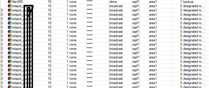

    Estamos tendo problema pra implementar uma rede PPPOE junto com outra rede que já esta funcionado: HOTSPOT+OSPF tudo via radius.
    Porem, quando o cliente pppoe autentica, e o OSPF divulga a rota, alguns minutos depois, o OSPF para de divulgar todas as rotas.
    Verificando no OSPF, vi que as interfaces do PPPOE estão sendo levantadas no OSPF como Point-to-Point.

    Clientes Hotspot 100% funcionando

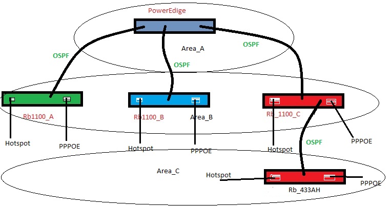

    Rascunho da rede:

    • Minhas configurações
    PowerEdige
    Loopback: 10.0.0.1/32
    ether1: Link Internet
    ether6: Hotspot (todos os cliente com ip dinâmico /30)
    ether2: OSPF___para____Rb1100_A (via_NBMA)
    ether5: OSPF___para____Rb1100_B (via_NBMA)
    ether7: OSPF___para____Rb1100_C (via_NBMA)
    /routing ospf instance
    set [ find default=yes ] name=LIMO_1 redistribute-connected=as-type-1 router-id=10.0.0.1
    /routing ospf area range
    add area=backbone range=186.y.y.0/20
    add area=backbone range=177.y.y.0/20
    /routing ospf interface
    add interface=LOOPBACK network-type=broadcast
    add interface=ether2 network-type=nbma
    add interface=ether5 network-type=nbma
    add interface=ether7 network-type=nbma
    /routing ospf nbma-neighbor
    add address=10.x.x.22 comment="Rb_1100_A"
    add address=10.x.x.10 comment="Rb_1100_B"
    add address=10.x.x.30 comment="Rb_1100_C"
    /routing ospf network
    add area=backbone comment=Loopback disabled=yes network=10.0.0.1/32
    add area=backbone comment="Rb_1100_A" network=186.y.y.144/28
    add area=backbone comment="Rb_1100_B" network=186.y.y.96/28
    add area=backbone comment="Rb_1100_C" network=186.y.y.112/28
    Rb1100_A
    Loopback: 10.0.2.5
    ether1: 10.x.x.22/30----------- ( fechando OSPF) -------- PowerEdige
    ether3: Hotspot (todos os cliente com ip dinâmico /30)
    ether4: (pretendemos usar pppoe)
    Rb1100_B
    Loopback: 10.0.2.6
    ether1: 10.x.x.30/30----------- ( fechando OSPF) -------- PowerEdige
    Rb1100_C
    Loopback: 10.0.2.7
    ether1: 10.x.x.10/30----------- ( fechando OSPF) -------- PowerEdige
    ether3_vlan1: (OSPF para Rb433AH)
    Rb433AH
    Loopback: 10.0.3.7
    ether1_vlan1: ----------- ( fechando OSPF) -------- Rb1100_C
    ether2: Hotspot (todos os cliente com ip dinâmico /30)
    ether3: (pretendemos usar pppoe)

    verifiquei que sua rede ospf e tipo nbma ou seja uma rede não broadcast ,numa rede deste tipo os roteadores não anunciam suas rotas visto que ele ja se conhecem então se uma interface cai ai fu#@$% para uma parte da rede o grande barato do ospf e poder criar redes que se uma interface cair ela muda para uma outra rota backup assim da tempo de descobrir o que aconteceu sem parar a rede .notei tambem que sua interface pppoe esta em estado down ja e um começo para começar a investigar ok.

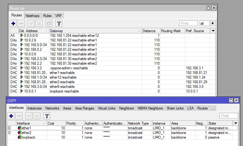

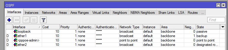

    Relatório de bancadas.
    • 3 notebook conectados em cada ponta com pppoe.
    • Não teve como testar junto, maquinas com hotspot e IP-staticos
    • Não aplicado filtro.
    • Area-A: CloudCore-1036
    • Areb-B: 2 Rbs 600
    Lembramos que em produção vai rodar junto com Hotspot+IP-staticos e tudo com IP-Publico.
    CloudCore-1036
Nome:	         2.jpg
Visualizações:	237
Tamanho: 	141,0 KB
    RB600_1
Nome:	         1.jpg
Visualizações:	234
Tamanho: 	37,2 KB
    RB600_2
Nome:	         3.jpg
Visualizações:	301
Tamanho: 	54,5 KB
    Aguardo comentários.
