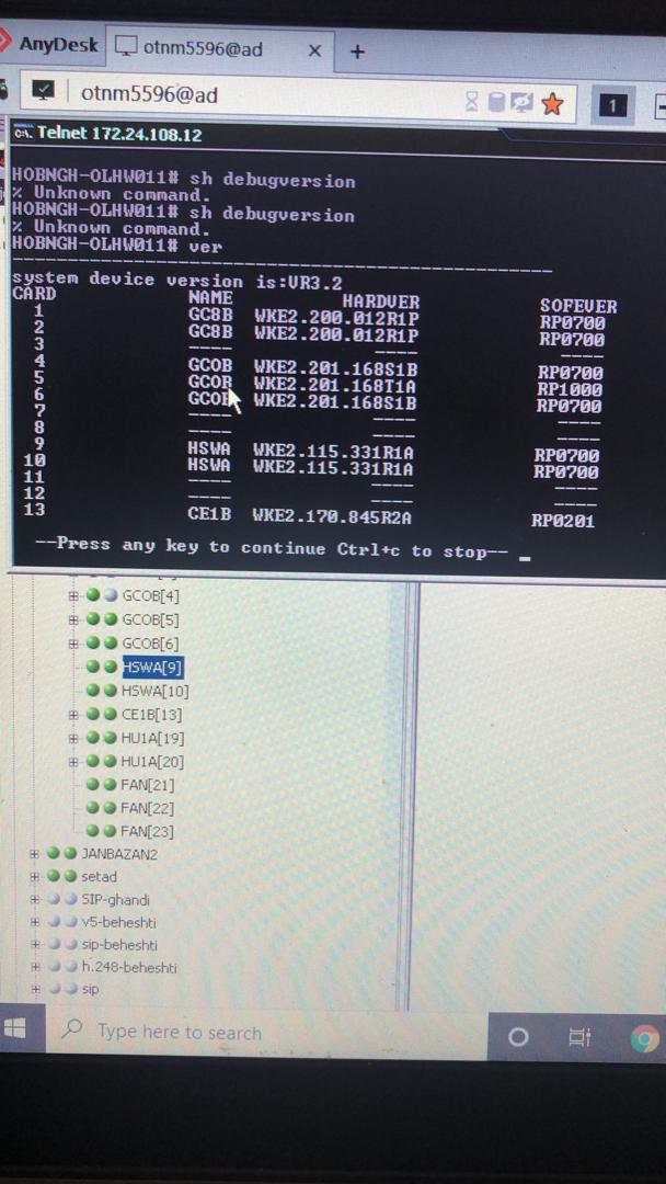

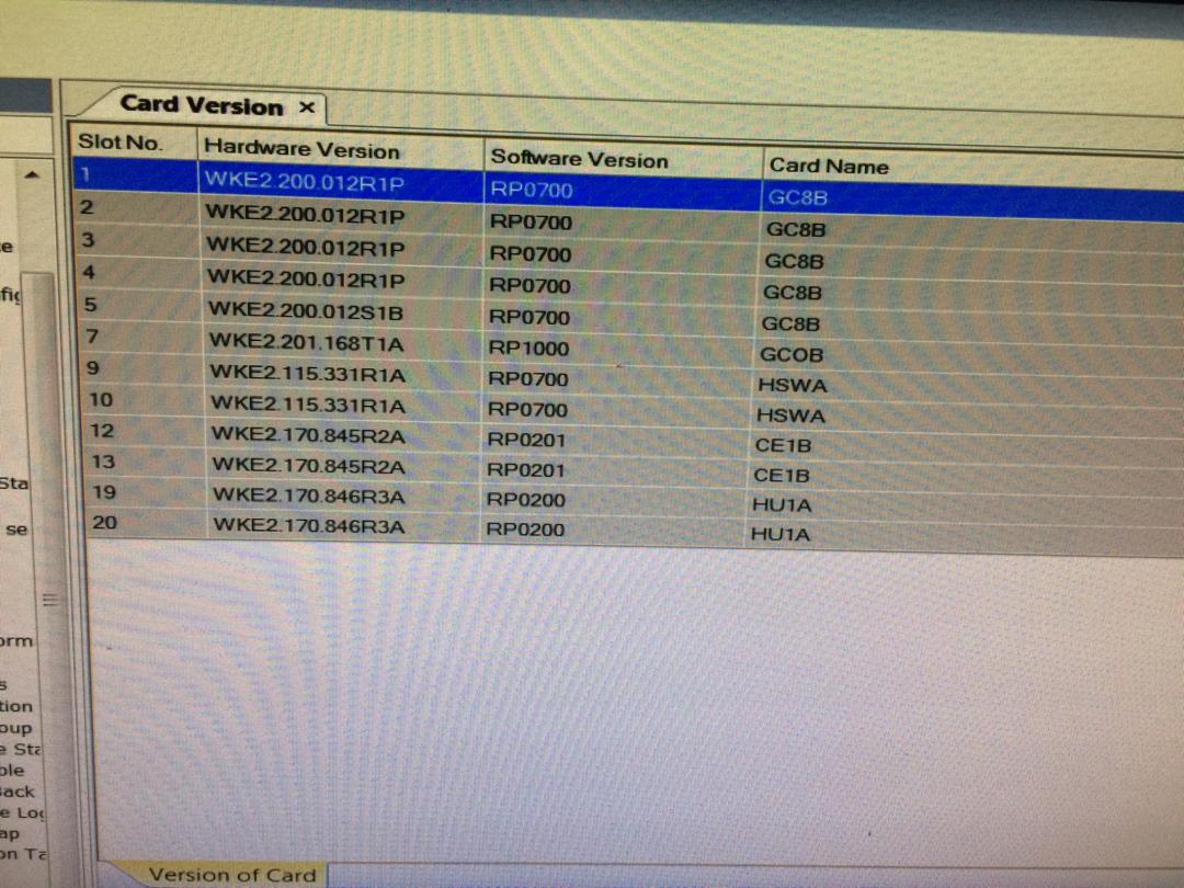

    Hi
    I also have a
    GCOB 168T1A which does not pass SIP traffic but it passes Internet traffic. The version is RP1000. I am attaching OLT and GCOB show ver.

    Anyone has a clue?
    Essa versão nova para rodar você precisa estar com a controladora HSWA na RP1000 tb e o software UNM 2000
